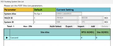

Yeah, I've imported the data, double checked it and its still deaf.
