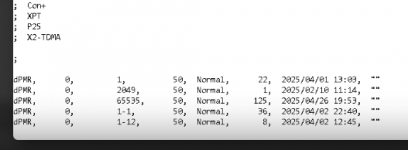

I know u can't set the priority in the scanlist file what i'm talking about is in the channel activity windows i'm able to right click to increase and left click to decrease the priority number. and when i go into the groups file it shows the priority of the frequency that i have in my scanlist. here is a screenshot of what i'm talking about. So i'm just asking if i have like 30 frequencies in my scanlist and i change two of those frequencies to like 20 and leave all the other ones at 50 will i always hear those two frequencies even tho it is scanning alot of frequencies ? not sure if u get what i'm saying or not .
Think you’re misreading something. Groups file has nothing to do with frequencies
Pretty sure priorities in groups and are only followed when in trunked mode. When using a scan list, you are not in trunked mode.
16,939
25,713
That list isn't read when scanning individual frequencies, when in scan mode it isn't doing trunking it is only scanning the frequencies.

I have never done any dPMR, but the tgid's look off. Pretty sure dPMR tgid/rid range is from 0 to like 9999999
Ok so if i have a dmr frequency and a coventional p25 frequency and a nxdn frequency in my scanlist and i change the priority number in the channel activity window like in the screenshot i sent so that will not make it become priority over the others even tho it lets me change the priority number? is that what u are saying?
16,939
25,713
YES!
Your changing a TGID's priority, not the frequency. 🍎 & 🍊's
