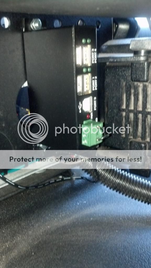

The Microsoft Surface Pro tablet will take center stage for the next round of improvements. Since the Surface runs Windows 8 all of the programs that are typical to storm chasing and amateur radio will be at my fingertips without the need for a full laptop or on-board computer. There are some drawbacks but it is easy to overcome, first is the USB 3.0 interface. Since there is only one USB port in the Surface Pro and several devices require power it stands to reason that a USB hub should be compatible AND be powered.
Then mount the hub to the front of the console. This shot is under the dash right in the middle between the speakers. Hidden but accessible.

Once the USB hub is installed
Port #1 goes to the dash camera:
Port #2 Goes to the GPS:
Port #3 goes to the USB port mounted on the console:
This USB port can be used to charge phones etc and it can attach to an outboard DVD / RW drive and all those benefits. More importantly it is an interface for programming radios such as the TM-D710a and the GreComm PSR-600. Now they can be truly re-programmed on the fly!
