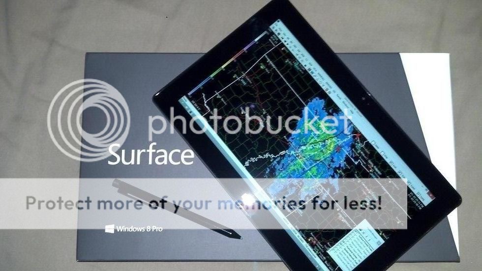

Additional parts & brackets have been ordered so in a week or two we will begin re-do-ing the dash mount for the tablet - computer. This means a total rebuilding of the video / live streaming system and I will probably take the opportunity to do some upgrades to the front console. Additionally, there are no replacement mounting brackets available for the WxWorx WR-10 weather receiver from Baron's so I'll have to make one from scratch.
Good thing storm season has been quiet this year.

WX4EMT
Jun 17, 2008
702
Tennessee
Nice. Hmm...do I see a wireless (bluetooth?) keyboard with built-in trackpad in the future? ;) (Assuming that would work, of course...admittedly I haven't paid much attention to the Surfaces...)
Yes, a small keyboard would be a nice addition, I'll figure that out eventually as well. For now my focus is on getting this stuff installed and tied together. My luck the truck will be lying in pieces when an unexpected storm rolls in.
The Surface is Windows 8 platform meaning it will run the RADAR programs GR Level 3 and GR Level 2 Analyst without issue but more importantly it will run Adobe Flash Media Encoder (to live stream video and record chases) something an Android platform won't do.
Another plus to a Windows platform is that I can run the satellite based RADAR program Mobile Threat Net for places where internet is poor or non existent. Essentially, I may not be able to send video but I will ALWAYS have RADAR and current weather conditions.
