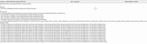

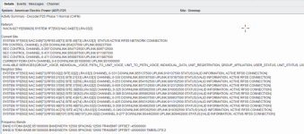

Sure.
Greenup KY
Catlettsburg (Boyd KY)
Ironton (which if I remember right is actually in Kitts Hill)
Those are the only three I'm actively receiving at the moment. South Point fades on me (I believe that's the one out near the college, so about 12 miles from me) I have a Lana coming and probably should look at some RF filters at some point. Lana is a temporary configuration until I can get a proper multicoupler in a few weeks.

Thank you!
