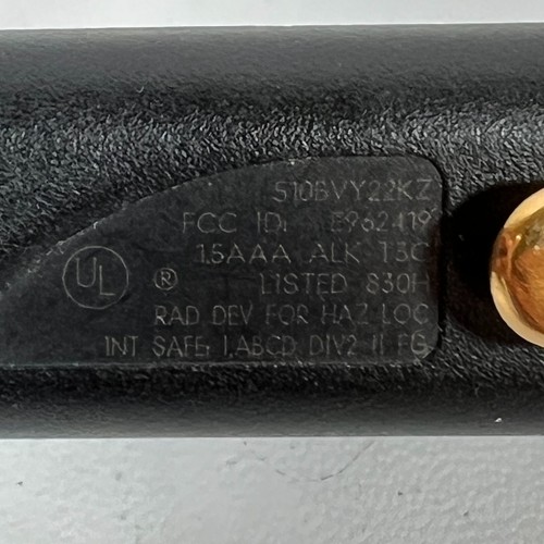

How can I know the Address of my Pagers?
Lup1n
Nov 8, 2023
4
Hello, they gave me 2 pagers, a Motorola GoldLine and an Advisor, in neither of them can I see the Address, I would like to be able to send a message with my SDR equipment, but I don't see it anywhere, at a hacking convention there was a pager that had his address written and we were able to send a message
WhatsApp Image 2023-11-07 at 7.47.41 PM.jpegWhatsApp Image 2023-11-07 at 7.47.28 PM.jpeg

i do not know if the batter door has what you want or if it is just a serial number.
Hello, as far as I saw it is just a serial number, the address is 7 digits as I saw

I have the frequency of the gold line, I don't see the frequency of the advisor, regarding the address, I can't find it for the goldline and I think I found it for the advisor but I'm not sure...

Exactly, it's not on any system, I want to do everything locally, I have a hackrf one with the porta pack, it has POCSAG, but I need the frequency (in goldline I have it) and the 7-digit address (in advisor I think I have it), But in advisor I think I only have the address and I don't have the frequency, and in goldline I have the frequency but not the address
15,771
If it is not on a system my response does not apply in this case. The only way I know of finding the address (Cap code) of a pager not on a system is to get the programming software and look at what was programmed.
