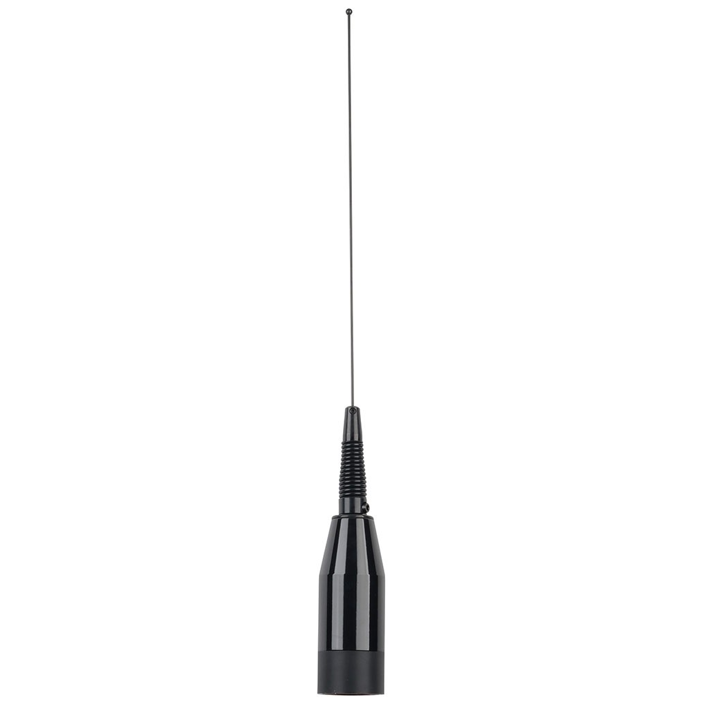

I've got an order in for a Sinclair tri band antenna, but it hasn't arrived yet. Mobile omni whip antenna, rugged design, tri-band covering 136-960 MHz

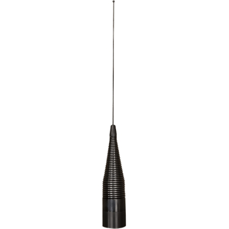

Motorola sells the rebadged version of this PCTel tri band antenna. I do NOT recommend these. Our county tried them for a while and they snapped off at the base from tree branch strikes. Not even remotely low profile.
This was the replacement antenna from PCTel, Motorola sells a rebadged version of it:
The spring is very 'floppy' and I ran one of these on my work truck for a grand total of 15 minutes before I removed it. Every pothole, bump, etc. would result in loud thumping as the antenna/spring flopped around on the roof.
