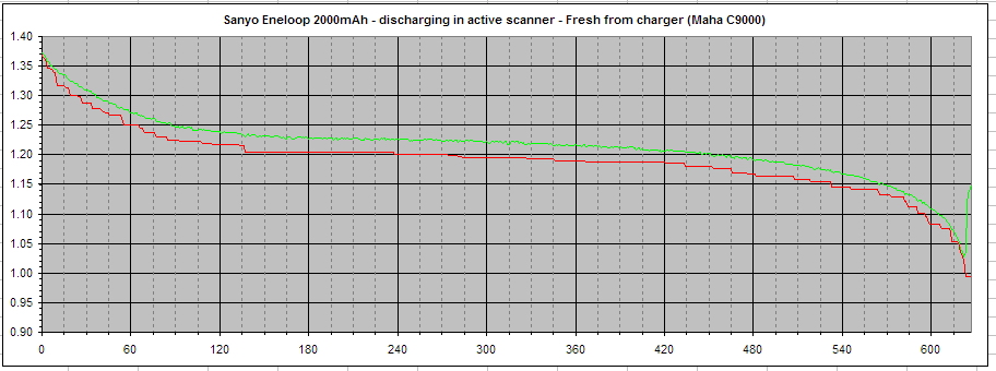

Rechargeable AA batteries are 1.2 volts charged.
Not always.
I've run several tests with brand-new Powerex 2700 and Sanyo Eneloop 2000 cells, freshly-charged in my Maha C9000. I'm measuring voltage with a Fluke 289 meter attached to the scanner's battery terminals. While powering the scanner (PSR-800, scanning CO DTRS), the discharge curve consistently looks like the below plot. The green line is the real-time value measured by the meter. The red line is the lowest value yet measured by the meter. The Y axis is per-cell voltage (measured voltage divided by 4). The X axis is minutes.
The real-time, under load voltage didn't drop to 1.2V/cell until ~7.5 hours into the 10.5 hour run. The minimum measured voltage did drop to that level much earlier.
I have my PSR-800 set to the default voltages. The battery icon seems to be pretty faithful to actual "time left".

Pretty hard to argue with data taken the right way with a load. :)
However with the new firmware my Sanyo 2700Ni-Mh batteries show full scale for only about 30 minutes and then fall off fairly quickly. I can get several hours on the empty Icon. Overall I get 7 to 9 hours total run time depending on volume, activity and back lighting. The battery Icon from the last firmware was pretty good for these batteries. Once the Icon was empty the scanner usually died within 30 minutes. Now it runs for hours. With the new settings I put in last night I still have one bar left and it's still scanning. I'm about 8 hours into the cycle now. I'm using an old MaHa charger and draining the batteries each cycle in the charger and then recharging. The batteries are 10 months old now and I have 5 sets I cycle through so I don't think they are dying yet.
Not always.
In the new firmware, there's a way to get a log of the scanner's internal battery measurements...
1. Delete the contents of the scanner's "Log" directory
2. In the "Settings" menu, check both "PC/IF CCDump" and "to file"
3. Put a fresh set of batteries in the scanner
4. Make sure the switch in the battery compartment is set correctly
5. Run the scanner until it does the low-battery auto shutdown. Do not power-cycle the scanner during this test.
6. Get the contents of the scanner's "Log" directory
7. In the retrieved log files, filter on the lines that contain "BattLevel" or "IconState"
You should be able to take the "BattLevel" lines and generate a plot of the batteries' discharge curve. The values in those lines, logged every 5 seconds, represent the lowest voltage yet seen by the scanner's CPU, x100 (e.g. 495 represents 4.95 volts).
As that minimum measured voltage crosses the thresholds (which you can set in the PC app), you should see "IconState" lines in the logs.
