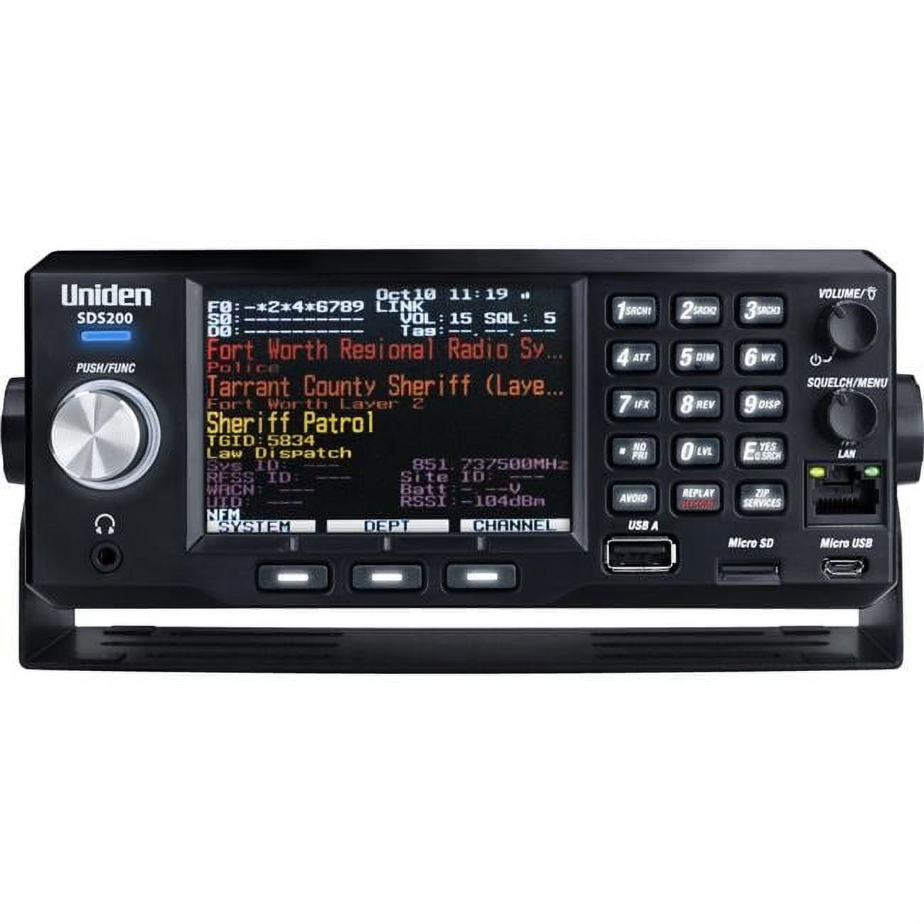

My location is just west of W.38th and Buckthorn. I tried using just the County site and avoiding the Urban site. I got no signal at all with the County and no reception. The Urban site shows 4 or 5 bars, and I hear most TG's. Overall reception with both sites active seems to vary some from day to day. My 536's on the 2nd floor sound ok, but the one on the first floor has me adjusting the telescoping antenna a lot. I have it extended all the way now and it helps some. Still considering an SDS200, but all the problems are scaring me away (loud hum, dispaly issues, etc.)

What radios are you seeing used with TG125? The one hit this morning was with radio 8200000, which is associated with west county fire.
Not sure if the SDS200 or 536 shows which radio is transmitting? West County makes sense, since that TG is close to the ones they use.

I got that info from PRO96Com. I already had it programmed so it has been around for awhile. It is probably an interop. Both the SDS200 & X36 will show the radio as Unit ID (UID).
