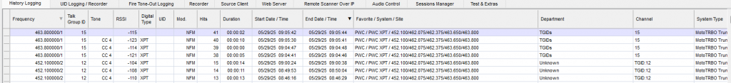

How can I get ProScan to display UIDs when monitoring a Hytera XPT system?
There is a column for it, but no data is displayed.
What type of scanner?
Do you see the UIDs in the display?
They should be logged if they are sent from the scanner. Can you look at the protocol in the Test tab and see if they are there.

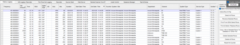

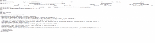

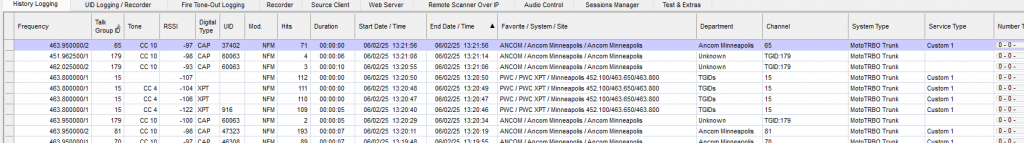

Right now I am monitoring a CAP+ system. The Uniden SDS100 shows UIDs. The Test screen populates the UIDs. However, my History Log does not save the UIDs. Is there a setting I should change on ProScan or the Uniden SDS100 to save that in the History Log?
Change this option to the 1st item like in this image and see what happens.
The Recorders grid(which includes UID Logging) is better sutable for UID logging. Same option in the Recorders options

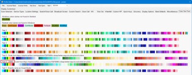

Next version is going to have a Profile Editor very similar to the one in Sentinel. I see several items that can be improved upon such as:
  • Profile Editor and FL Editor separate file operations
  • Location Settings tab - DMS format 4 decimal places to minimize rounding errors
  • Multiple instance running same time
  • WinForms and messages centered over the app
  • Improved Waterfall and Display Customizer color picker. Colors sorted by HSL and not color names
  • A few more small items
Here is the 1st look at the Display Customizer. I made it to work and look almost like the one in Sentinel.
Something I was playing around with.
