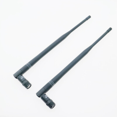

@Cheeseburgers how does it compare to the Remtronix antenna for the SDS?
Better, DM me your address ill send you one

I was parked on H and it was rather chatty last night, L a little less. Bloomfield is busy on H I've noticed... Shouldn't have parted with the G5 I could have compared. Ah well, it appears the 325p2 w/ this antenna does quite well, the RS800 was 2/3 bars from my location, the Shure is full strength and clear audio.
