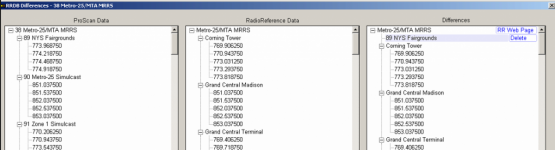

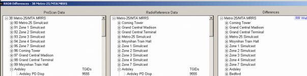

Proscan or Radio Reference db issue?
MTA MRRS has a new site listed in the database and Proscan is not seeing it with RRDB differences.
The site was added today.
If I import the whole system, its there. If I move the site from the import into the existing system, and run RRDB, it wants to delete the site.
Its not seeing it on Radio Reference.
