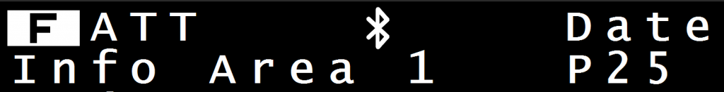

To anyone that has the SDS150 and using ProScan
I need a test performed to get the bluetooth symbol hex code/s in the protocol.
Post here the code/s so others don't test.
With ProScan communicating with the SDS150, go to the Test & Extra tab and see what the 1st few ASC hex codes are. It will be before the date. It may be just one hex code.
Bluetooth symbol looks like this
@jasonhouk @N9JIG

I received my SDS150 today. A few display issues:
X bluetooth symbol move 1 position right
GPS reversed colors not showing B4, BE, BF
satellite signals missing rectangles
?check location deg, minute, second symbols are ok
